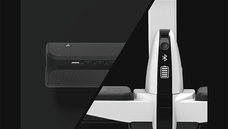

Connect Ninebot Engine Speaker to Ninebot self-balancing vehicles
Take Ninebot S-PRO for instance
NOTE: Please ensure the S-PRO firmware has been updated to the latest version in the Segway-Ninebot app. Before pairing with the speaker, disconnect the app from the S-PRO.

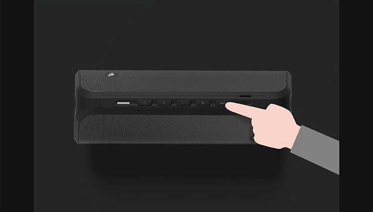

1. Press the power button to turn on the speaker. The white indicator means vehicle mode and the blue means music mode.
2. If the indicator is blue, please press the Mode button to switch it to white.
3. Power on the S-PRO, the Bluetooth indicator should be flashing. If the indicator is solid blue, it means the S-PRO is connected to another device (such as the Segway-Ninebot app). Disconnect the device from the S-PRO first until the Bluetooth indicator flashes.
4. Press and hold the Mode button to start pairing. Follow the voice prompt to complete the pairing (the indicator is white with double flashes).
5. Once the pairing is successful, the speaker indicator will be solid white, and the Gokart indicator will be solid blue.
