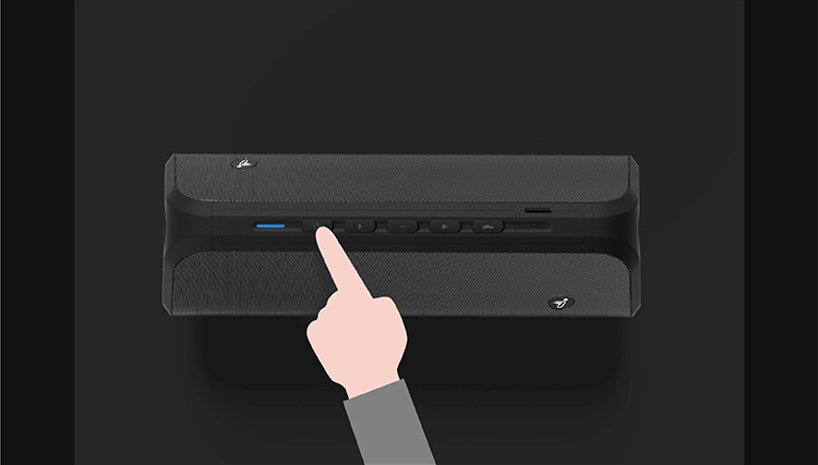

1. Press the power button to turn on the speaker. The white indicator means vehicle mode and the blue means music mode.
2. If the indicator is blue, please press the Mode button to switch it to white.

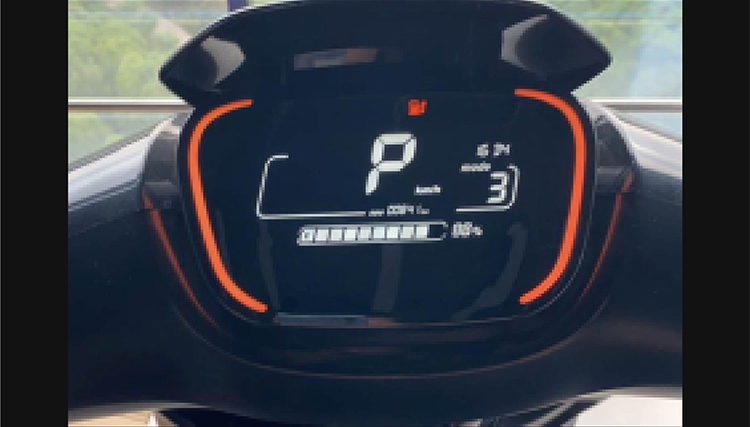

3. Power on the eScooter, the Bluetooth indicator should be flashing. If the indicator is solid blue, it means the eScooter is connected to another device (such as the Segway-Ninebot app). Disconnect the device from the eScooter first until the Bluetooth indicator flashes.

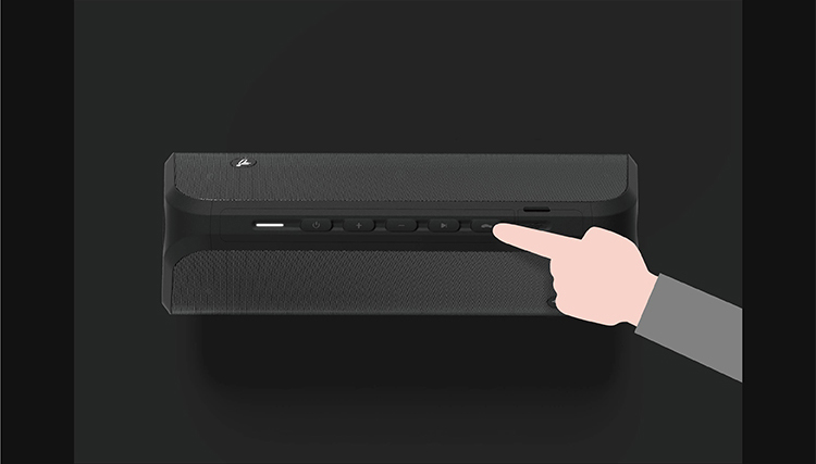

4. Press and hold the Mode button to start pairing. Follow the voice prompt to complete the pairing (the indicator is white with double flashes).

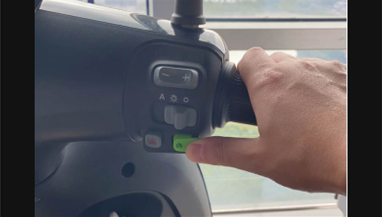

5. After the eScooter is found, follow the voice prompt (press the power button) to complete the pairing.
